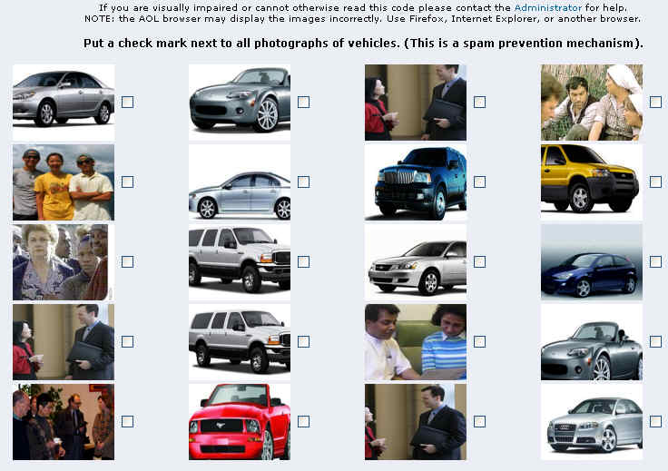

Uff - the MOD shows 20 pictures. :shock:
Beitragvon jeepguy_1980 » 22. Aug 2007 23:34
I looked at your mod, and it too seemed to affect the commented lines. That was before I realized that the lines had been moved.
The reason the photo recognition mod uses so many pictures is that it asks the user to select all of the pictures from a specific category, rather than force the user to decipher the difficult text captchas.

Yes I have understood which the MOD does. But 20 pictures seems to be me a little much. :roll:

The Photo-Recognition is a nice idea. I only find 20 pictures really exaggerated!
Zugefügt nach 3 Minute(n):
Ah - Here is a code to define how much pictures should shown. 8)
