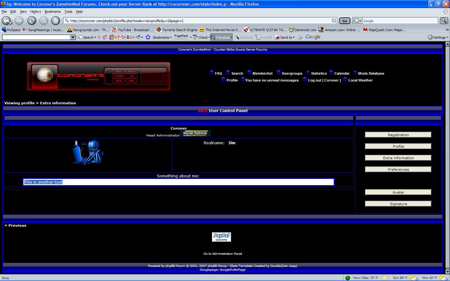

Thank you once again for all your help and patients with me. I'm not the best at planting codes and some times I do rush a bit but it's all about learning for me.
I put in the file but for some reason the comment field is highlighted so you can't see the actual comments? I attached a screen shot for you to see what I'm talking about.

Beitragvon AmigaLink » 29. Jul 2007 19:01
If you everything cancel again and again we never will be finished :!: :?
And there is still the issue with the buttons remaining white as you can also see in the screen shot.
Any ideas as to what I need to do to make them look like the other buttons?
I say it again:I have fix that in the files those I post for you at posting #4 !!! :roll:
White writing on white background cannot function. ;)

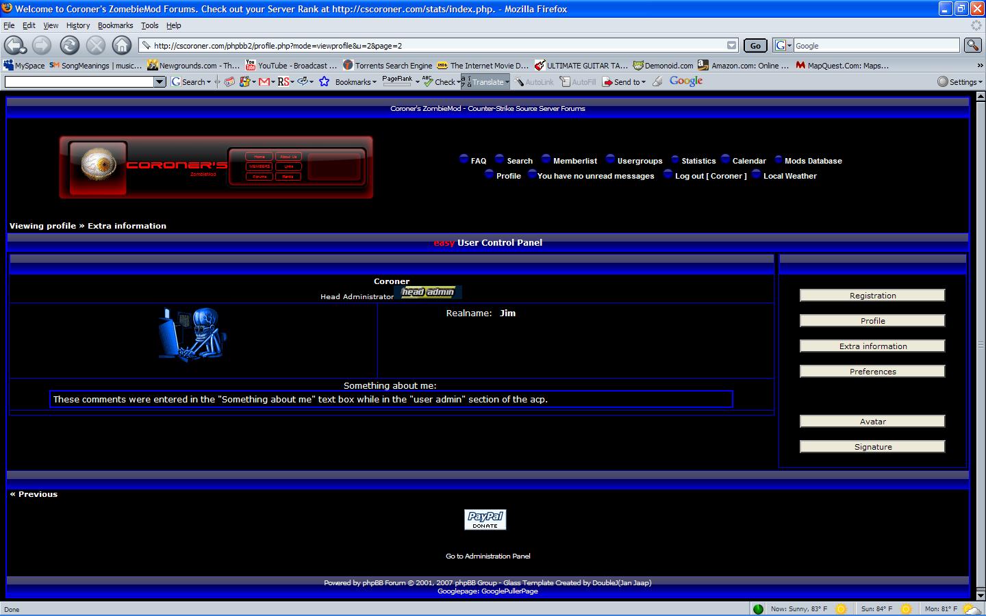

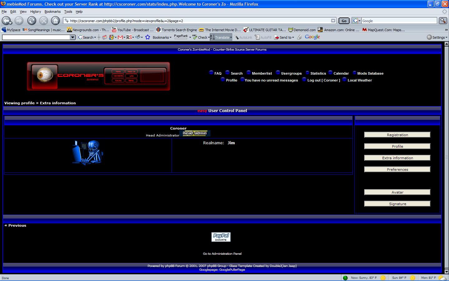

What I just finished was a complete re edit of a back up usercp_register.php and the debug is gone but the only place I can enter comments and make the comments hook is in acp under user admin, user list. There I can click on my account or my test account, enter the comment and click submit and it hooks perfectly. If I go to the main index, click on profile then click extra information, enter comments and click submit, then it resets to blank erasing any comments I entered.
First screen shot if of the extra info with comments entered in the acp"
Second screen shot is what happens after I enter comments in the "Edit your profile" text box.
You can see that it only hooks from the acp but not from the profile section?

Beitragvon oxpus » 30. Jul 2007 00:38
Simple:
Regard these two lines:
//   $trim_var_list = array('cur_password' => 'cur_password', 'new_password' => 'new_password', 'password_confirm' => 'password_confirm', 'signature' => 'signature', 'user_about' => 'user_about', 'user_about_bbcode_uid' => 'user_about_bbcode_uid', 'user_allow_viewprofile_2' => 'user_allow_viewprofile_2');
   $trim_var_list = array('cur_password' => 'cur_password', 'new_password' => 'new_password', 'password_confirm' => 'password_confirm', 'signature' => 'signature', 'ucp_mode' => 'ucp_mode');
In the first line you've insert the variables for the user about field, but the line is commented!
So insert
in the second line to enable the user about in the user profile itself.
Just be more concentrate while installing a MOD or Add-On...
Beitragvon Coroner » 30. Jul 2007 04:36
Worked perfectly! Thank you so much.
